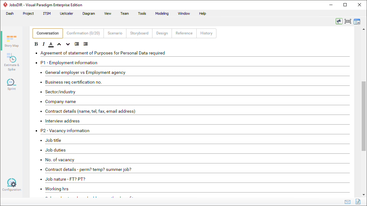

  • This conversation is mostly verbal but most often supported by documentation and ideally automated tests of various sorts (e.g. Acceptance Tests).

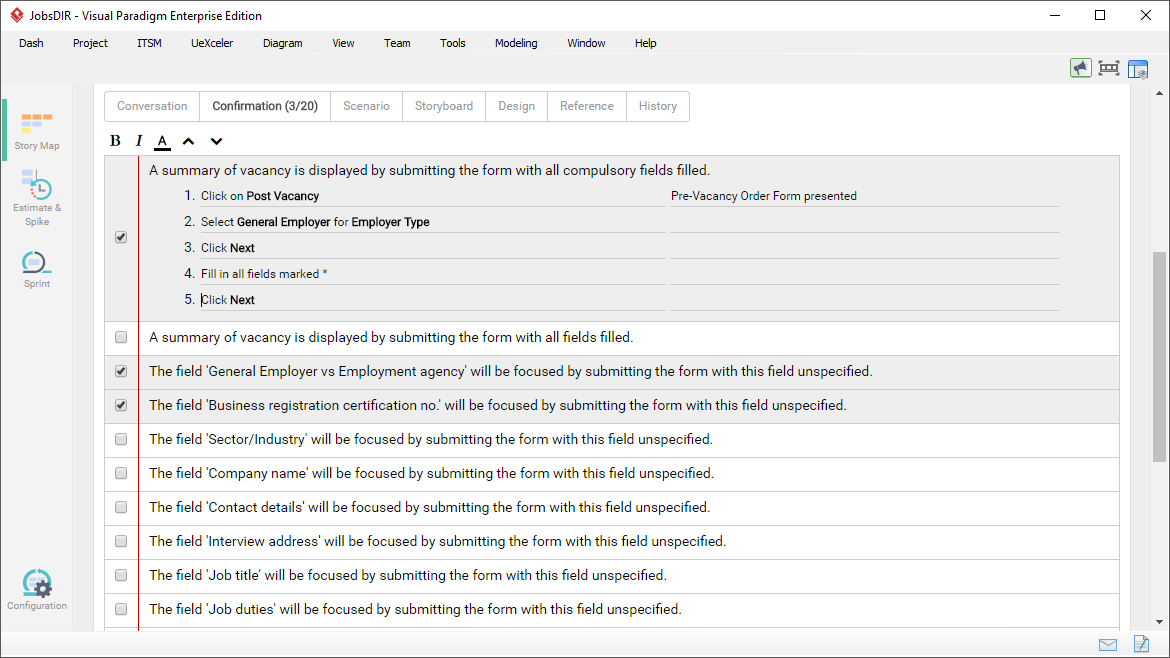

Confirmation represents the Acceptance Test, which is how the customer or product owner will confirm that the story has been implemented to their satisfaction. In other words, Confirmation represents the conditions of satisfaction that will be applied to determine whether or not the story fulfills the intent as well as the more detailed requirements.
  • The Product Owner must confirm that the story is complete before it can be considered “done”
  • The team and the Product Owner check the “doneness” of each story in light of the Team’s current definition of “done”
  • Specific acceptance criteria that is different from the current definition of “done” can be established for individual stories, but the current criteria must be well understood and agreed to by the Team. All associated acceptance tests should be in a passing state.
    user story confirmation

A scenario is a narrative, which describes how a user might interact with a website or software application which focuses on users’ needs rather than the technological aspects of design. It allows us to explore the user interaction in more detail, to describe the necessary steps and their relationship. It important as these enable usability experts and developers to get into the mindset of potential users. Another benefit of user scenarios is that they are written in a language that all team members should understand, regardless of specialism.

In Visual Paradigm, you can use the Conversation Part of the user story to refine into narrative steps to be stored under user story scenarios as suggested in option one above. By this way, you can attach wireframes to each of the steps for UX planning and design. After you finished with the scenario and wireframes, you can output wireframe storyboard slide show and as well as use case report embedded with wireframe design in the specification.
