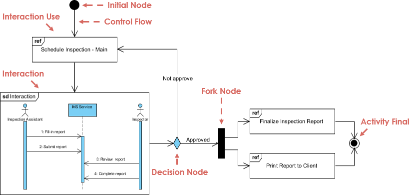

UML Interaction Overview Diagrams provide a high level of abstraction for interaction models. It is a variant of the Activity Diagram where the nodes are the interactions or interaction occurrences. The Interaction Overview Diagram focuses on the overview of the flow of control of the interactions which can also show the flow of activity between diagrams. In other words, you can link up the “real” diagrams and achieve high degree navigability between diagrams inside an Interaction Overview Diagram.

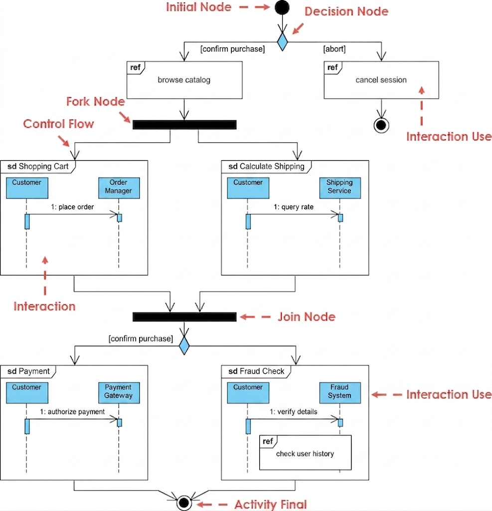

The UML Interaction Overview Diagram that maps the high-level control flow of an online purchase process. It uses a hybrid notation that combines activity diagram nodes with sequence diagram frames to visualize complex interactions.
Following the style of image_aa070d.png, this diagram utilizes several standard UML elements to define the workflow:
Initial Node: Represented by a solid black circle at the top, this marks the starting point of the purchase process.
Decision Nodes: These diamond-shaped symbols represent branch points where the flow chooses a path based on guard conditions, such as [confirm purchase] or [abort].
Fork and Join Nodes: Horizontal black bars used to manage parallel processing. The Fork Node splits the flow into concurrent tasks, while the Join Node synchronizes them back into a single flow.
Interaction Uses (ref): These rectangular boxes with a “ref” tag in the corner act as placeholders for other detailed interactions, such as browse catalog or cancel session, which are defined elsewhere.
Interactions (sd): These frames (labeled with “sd”) provide nested Sequence Diagrams that show direct communication between lifelines, such as the Customer and the Order Manager.
Activity Final: A “bullseye” symbol at the bottom indicating the successful or unsuccessful completion of the entire process.
The diagram breaks the purchase down into three primary stages:
The process begins at the Initial Node and immediately hits a Decision Node. If the user chooses to [abort], the flow moves to the cancel session interaction and ends. If they [confirm purchase], the flow enters the browse catalog interaction.
After browsing, the flow hits a Fork Node. This triggers two concurrent interactions:
sd Shopping Cart: The Customer sends a 1: place order message to the Order Manager.
sd Calculate Shipping: Simultaneously, the Customer sends a 1: query rate message to the Shipping Service.
These two paths must both complete before reaching the Join Node.
Once the order and shipping details are synchronized at the Join Node, a final Decision Node directs the flow:
sd Payment: The Customer authorizes payment via the Payment Gateway.
sd Fraud Check: The Customer details are verified by the Fraud System, which includes a nested ref call to check user history.
The process concludes at the Activity Final node, signifying the order has been processed.

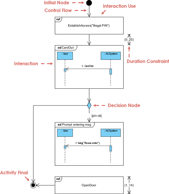

The Interaction EstablishAccess occurs first with argument “Illegal PIN” followed by an interaction with the message CardOut which is shown in an inline Interaction.
Then there is an alternative as we find a decision node with an InteractionConstraint on one of the branches.
Along that control flow we find another inline Interaction and an InteractionUse in the sequence.

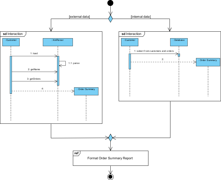

In this diagram, we want to produce and format an order summary report. If the customer is external, we get the information from XML; if internal, we get it from a database. Small sequence diagrams show the two alternatives. Once we get the data, we format the report; in this case, we don’t show the sequence diagram but simply reference it with a reference interaction frame.
*extracted from UML Distilled 3 interaction overview example
